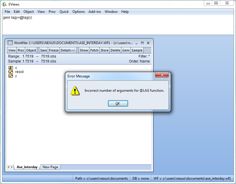

hi for all,
1/ @lag(x) is the equivalent to x(-1), when i use this function a message appear see the picture bellow, but @lag(y,1) works well, what is the problem?
2/ the order difference of the function d(x,n) take natural number, I thought that in this version 8.1 it can take the real number 'I'm a little disappointed'.
thanks for all your efforts for this version.
lag 1.png (49.92 KiB) Viewed 3347 times

Postby EViews Gareth » Wed Sep 24, 2014 10:10 am
1. @lag does require the second argument. We should update the documentation. Sorry!
