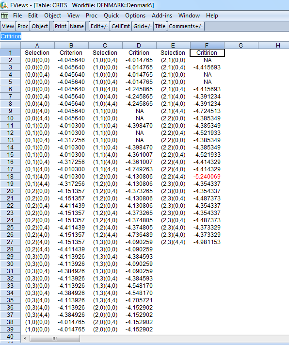

hi everybody.
i have two suggestion:
1-ARMAX: this Add-in select the best order of AR, MA, SAR, SMA, if i have exogenous variables Xi what is the best lag order for each variables to minimize AIC HQ and BIC. can you add an option to use max lag for exogenous variables up to 10 lags, it would be useful to chow the best model ARMAX. :), and chow in ouput table the selected model.
2-critical value: how can chow the table by columns by 39 row for example.
I hope that you consider my suggestion for this add-in, unfortunately I'm not an expert in programming in EViews
have a nice day for all.

1-how can estimate best model without constant C, it can not do this.
2-when i use the Add-in to search best model it show table with the order lag selection like this (p,q)(P,Q), how can change the code to show it like this (p,d,q)(P,D,Q), why do you not put the regular and seasonal differencing? in X-13 options i can find it.
Re: ARIMASel (Automatic ARIMA selection)
Because the procedure always tests an (0,0,0) model, it needs at least one regressor (such as a constant), otherwise there is nothing to estimate.
You could change the code so that it starts at a (1,0,1) model if you wanted by changing the AR/MA loops so that they start at 1 rather than 0.
Since the selection criteria have no impact on deciding the differencing level, the d,D terms in the table are redundant (they would be the same for every model), so they're dropped to keep the table neater.
