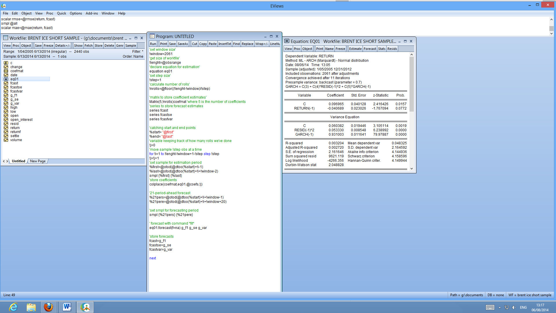

I have now been able to get the same forecast results by trying the two different methods (commands and dropdown menu), which I am really happy about! :)
However I still get incorrect answers for RMSE and MAE. I have not been able to update eviews yet, as I am not allowed to do it myself as only admins are entitled to do it at the university.
Do you think m problems are caused by not having the latest update, or am I doing something else incorrectly?
Nicole
Screenshot (93).png (222.52 KiB) Viewed 14136 times
Posts: 13610
Re: Multi-step ahead forecast
Postby EViews Gareth » Mon Aug 04, 2014 12:01 pm
Your sample is set to a single observation. RMSE and MAE will give identical results for a single observation.

Furthermore, when I change my program from 1 day to 21 days:
'1-period-ahead forecast
%1pers=@otod(@dtoo(%start)+!i+!window-1)
%1pere=@otod(@dtoo(%start)+!i+!window+0)
'set smpl for forecasting period
smpl {%1pers} {%1pere}
'21-period-ahead forecast
%21pers=@otod(@dtoo(%start)+!i+!window-1)
%21pere=@otod(@dtoo(%start)+!i+!window+20)
smpl {%21pers} {%21pere}
The forcasted values remain the same.. Why? :?

Postby Nicole » Wed Aug 06, 2014 3:53 am
aah thanks, that helped! :D
However I have run into another problem. When changing my step-ahead forecast from 1 day to 21 days as shown above, I get the same forecast values. Do I need to change anything else than "period-ahead" and "sample for forecasting period" in my program in order to change the horizon?
Posts: 13610
Postby EViews Gareth » Wed Aug 06, 2014 4:46 am
Use .forecast rather than .fit

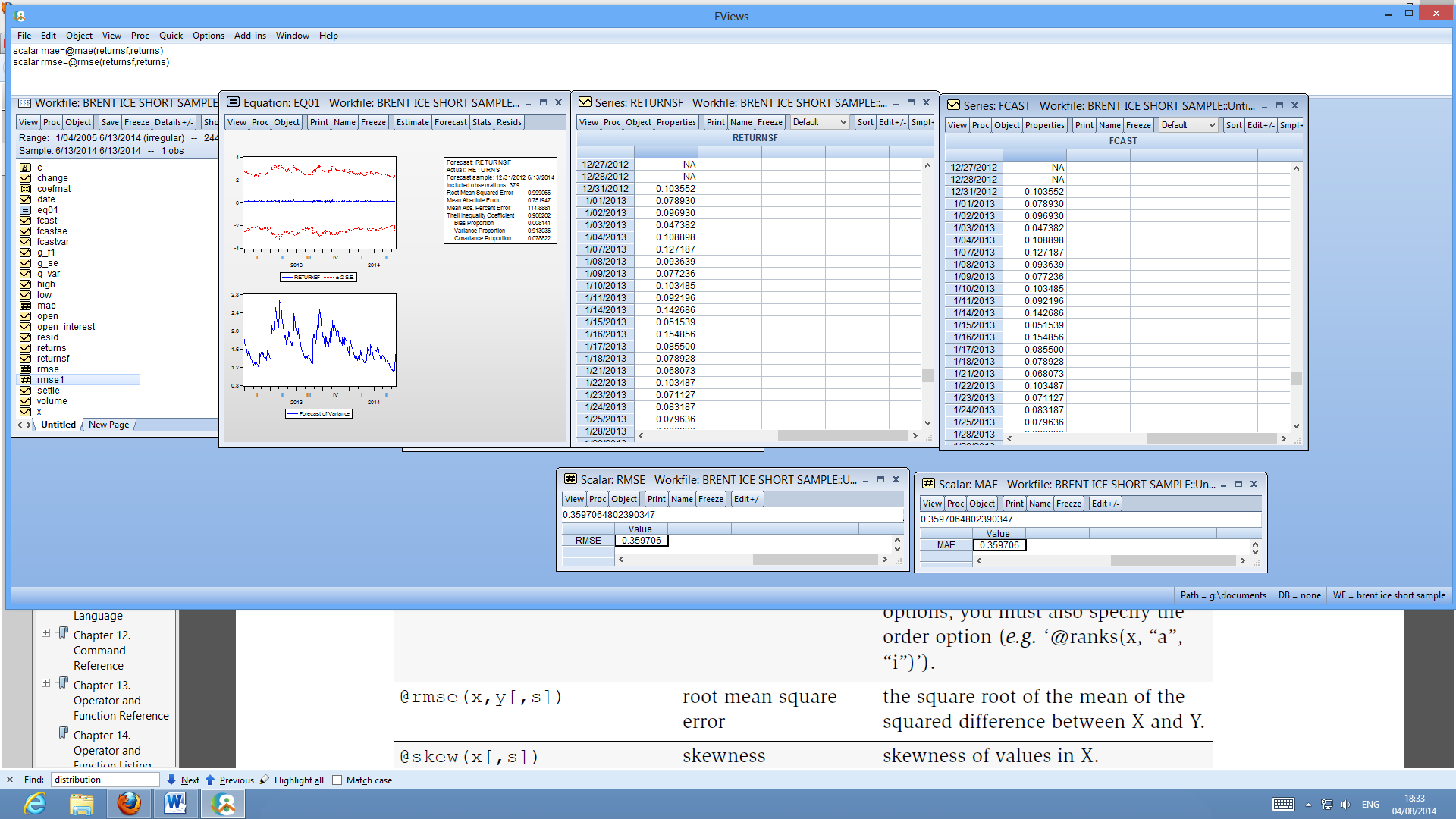

Postby Nicole » Wed Aug 06, 2014 5:23 am
I have changed it but still get the same forecast values as I do when I forecast for 1 step ahead.
I really do not see what I am doing wrong, to me my program looks correct... :shock:
