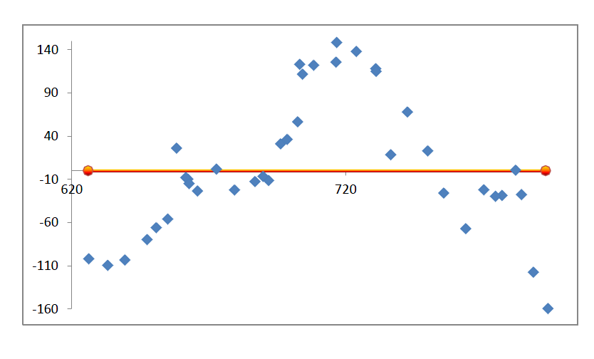

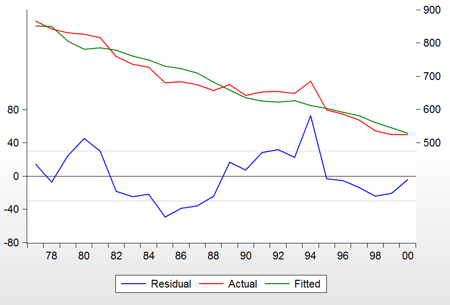

And this is how the residuals look like in Excel, and Eviews. Do you see the difference and what i meant? Where am i going wrong? How could i verify that this model is a good one or has misspecifications?

Re: Power function estimation in Eviews
on excel:
- no randomness of residuals
- durbin-watson = 0,19
hence, i was thinking that there was a misleading model.

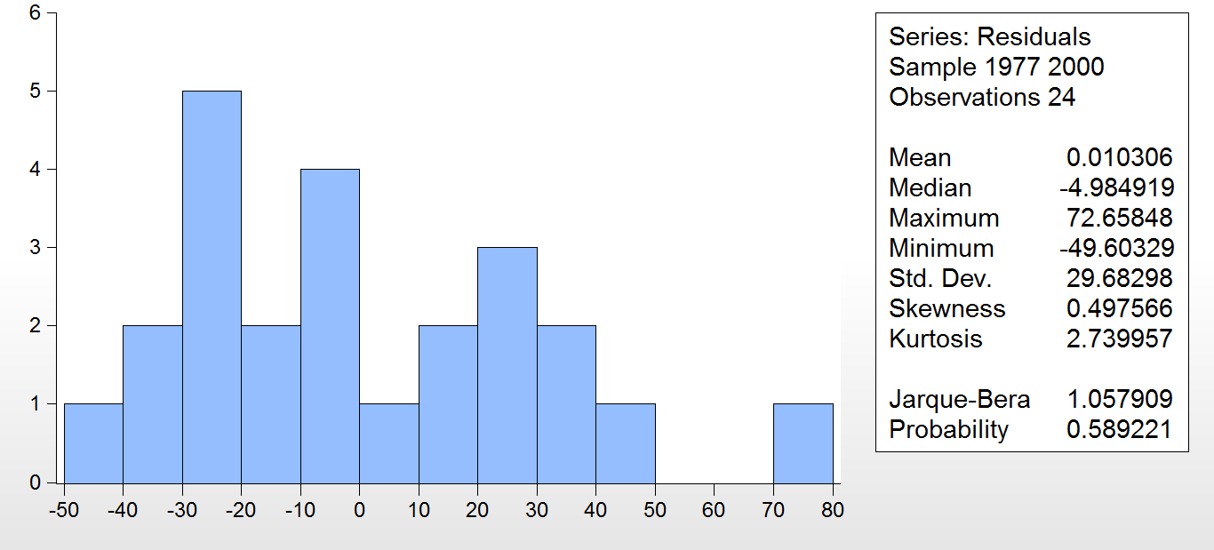

Did Eviews, maybe adjust something automatically from this model? Or do you still see any inconvenience in the residuals graph? Histogram attached.
First of all, the two results are not "close". Nonlinear models are sensitive to initial conditions as well as to the changes in parameter values. And they are also susceptible to local optima. In this case, however, you can linearize the model by applying logarithmic transformation to the variables. You can then run a simple OLS and this should yield the same output for EViews and Excel.
log(iu_at) = c(1) + c(2)*gdp_cap_atWho is online
