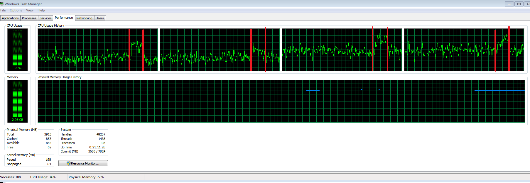

Delay occurs after clicking left mouse button on the second time series: windows 7 blue "working" circl appears and Eviews do not respond for a while. Workfile size is 878 KB. and it contains approximately 500 objects, most of them are time series 118 observations each. I tried to reproduce this delay in small workfile and I could not get it. So it is a problem of big workfile. Does it mean that I need more powerful machine? Or how can I optimise mine? In the attachment you can find CPU usage print screen. Eviews delay is between red lines.

500 objects is actually pretty small. (We have test files with hundreds of thousands of objects using gigabytes of memory).
I notice that there's a fair amount of other activity going on on your machine at the same time. I assume this isn't EViews, since EViews normally doesn't use any CPU when it is idle.
