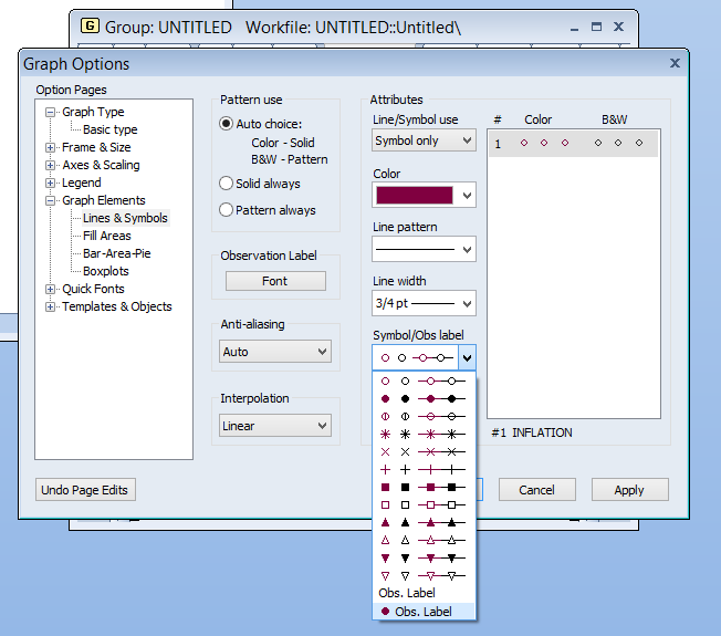

What I see on my EViews 8 is Graph Options -> Graph Elements and I do not find "Symbol/Obs Label".
What I found is that there are four modules under Graph Elements: Lines & Symbols, Fill Areas, Bar-Area-Pie, and Boxplots. Which one I should go with? I clicked on Lines & Symbols and did not find anywhere I could turn on obs labeling.

Postby EViews Gareth » Tue Mar 04, 2014 5:34 pm

So, where can I turn on obs label on the page you showed? Just choose "Auto Choice" and/or "Symbol Only"? I did both and it made no difference. Still says "Graph has no obs/date axis" and no obs label shows up.
