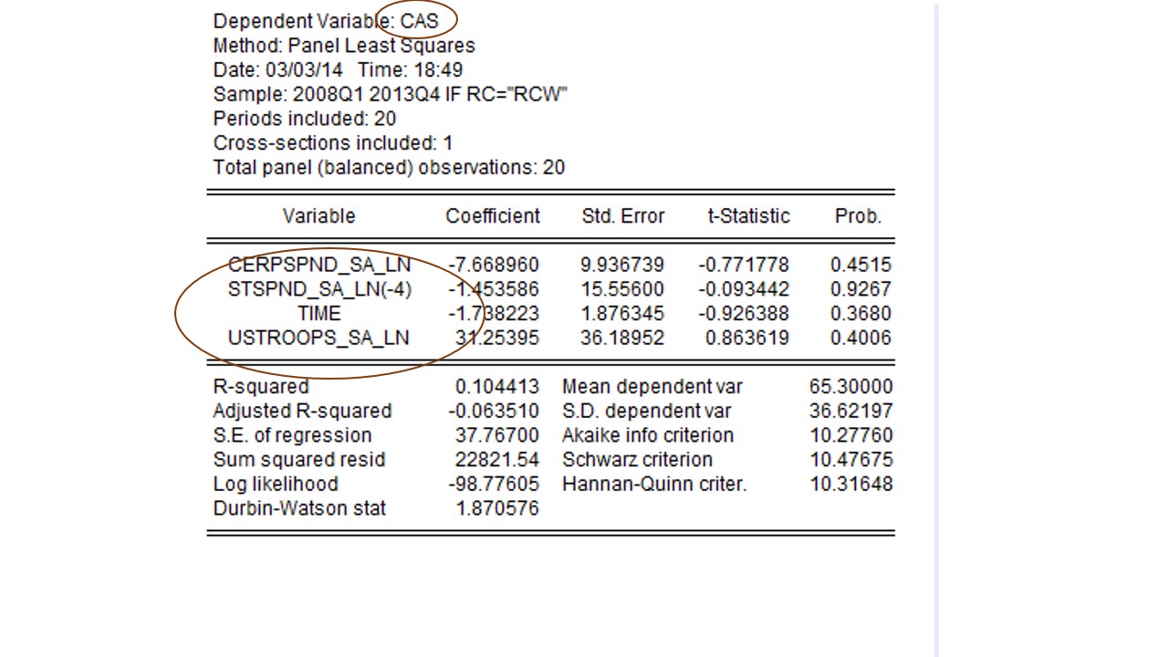

I am curious if there is a way to grab each independent variable name separately from an regression equation output. I am running several models with time lags and am having the results captured in a table to quickly examine all of them as a group as opposed to comparing each one individually. I have been able to get the coefficients and p-values for the dependent variables, but I can't seem to find a way to capture the names of the dependent variable and independent variables. As the equation changes each time I do a comparison or add data, I would like the system to recognize there are now 4 instead of 5 variables, and apply those new variable names to the table.

Postby EViews Gareth » Tue Mar 04, 2014 10:10 am
equation.@varlist.
You should take a look at the source code for the eqtabs add-in. Probably has a lot of stuff similar to what you're trying to do.

I've been using the @varlist currently, but was hoping there was something allowing me to pull out each variable independently, something like @varlist(i).
I'll look into the eqtabs. Thanks again.
Re: Grabbing Variable Names
Postby EViews Gareth » Tue Mar 04, 2014 11:10 am
@word(@varlist, !i)
