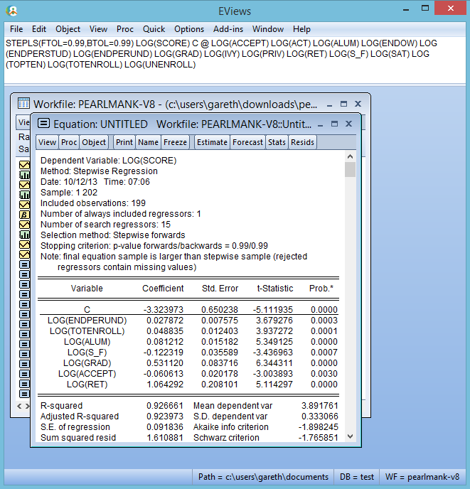

I cannot replicate your results...

I used combinatorial to show that in MY CASE the stepwise stopped too soon. I could have done it by hand but thought better to show it via combinatorial - but MATCH is not THE issue although it is an issue.
Issue #2: the combinatorial produces a nothing NO VARIABLES selected
STEPLS(METHOD=COMB,FTOL=0.9,BTOL=0.9,NVARS=8) LOG(SCORE) C @ LOG(ACCEPT) LOG(ACT) LOG(ALUM) LOG(ENDOW) LOG(ENDPERSTUD) LOG(ENDPERUND) LOG(GRAD) LOG(IVY) LOG(PRIV) LOG(RET) LOG(S_F) LOG(SAT) LOG(TOPTEN) LOG(TOTENROLL) LOG(UNENROLL)-
Re: stepwise with log of non positive values
Ah, I think I see your confusion. The key is the warning message printed at the top of the output:
In your particular case the number of observations used during the stepwise procedure is 8. Not surprisingly with only 8 observations, combinatorial (forcing 8 regressors) breaks down. Similarly, a forwards routine will stop before the model becomes singular due to a lack of observations.
Note: final equation sample is larger than stepwise sample (rejected
regressors contain missing values)
I am well aware of the warning message. Eviews 7 did not warn, it would not do the regression.
I now see where you say 8 observations (common sample), but why then
Number of observations: 8
Are you saying you use the cross product matrix common sample for ALL the variables, make the selection, and then EXPAND the data set for that particular regression. If so could you please point to a reference? And I would ask that the generic message be replaced with an exact message, something like 'Selection is based on ## observations while the final regression displayed is based on ## observations'. At least then someone like me will not waste time again.
STEPLS(METHOD=COMB,FTOL=0.9,BTOL=0.9,NVARS=7) LOG(SCORE) C @ LOG(ACCEPT) LOG(ACT) LOG(ALUM) LOG(ENDOW) LOG(ENDPERSTUD) LOG(ENDPERUND) LOG(GRAD) LOG(IVY) LOG(PRIV) LOG(RET) LOG(S_F) LOG(SAT) LOG(TOPTEN) LOG(TOTENROLL) LOG(UNENROLL)
From the manual:
We'll take your suggestion on board.
Following the Stepwise selection process, EViews reports the results of the final regression,
i.e. the regression of the always-included and the selected variables on the dependent variable.
In some cases the sample used in this equation may not coincide with the regression
that was used during the selection process. This will occur if some of the omitted search
variables have missing values for some observations that do not have missing values in the
final regression. In such cases EViews will print a warning in the regression output.
Well I looked around at the help files but likely I did not look at the manual but only the help files. My fault I guess.
Again, do you have a references about this method to handle missing values in a stepwise proceedure?
Help files are identical to the manual.
We do not have a reference.
