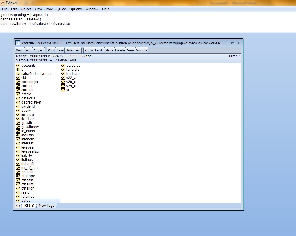

I am very new to eviews and statistical programs in general. I want to analyse a huge data set in eviews version 7.
I have watched some tutorials on youtube and began reading in the user guide, but i have come to a point where I am quite unsure what sort of keywords i need to look for in order to solve my problem.
I hope you guys can help me by giving me advice and/or pointing me in the right direction and i apologize for what might seem like "nooby" questions.
The Data
I have a data set of 300k companies between the years 2000 and 2011.
For each company I have a number of variables in the form of accounting data (Assets, Liabailites, Profit, Leverage, Listing status and so on)
I know already that this means i have either pooled or panel data.
The unique ID (for cross sections) i used when structruing the file is company ID nr and i used the year for the time series ID.
In addtion I have a parameter that provides information about what industry the company operates in (8 industry types with a numerical id between 1-8).
By taking a closer look at the data however I realized that some companies have different industry IDs in different year (which means they changed the industry sector between years).
From what i can tell this is a minority of the data set, but I am not sure if this could cause a problem later.

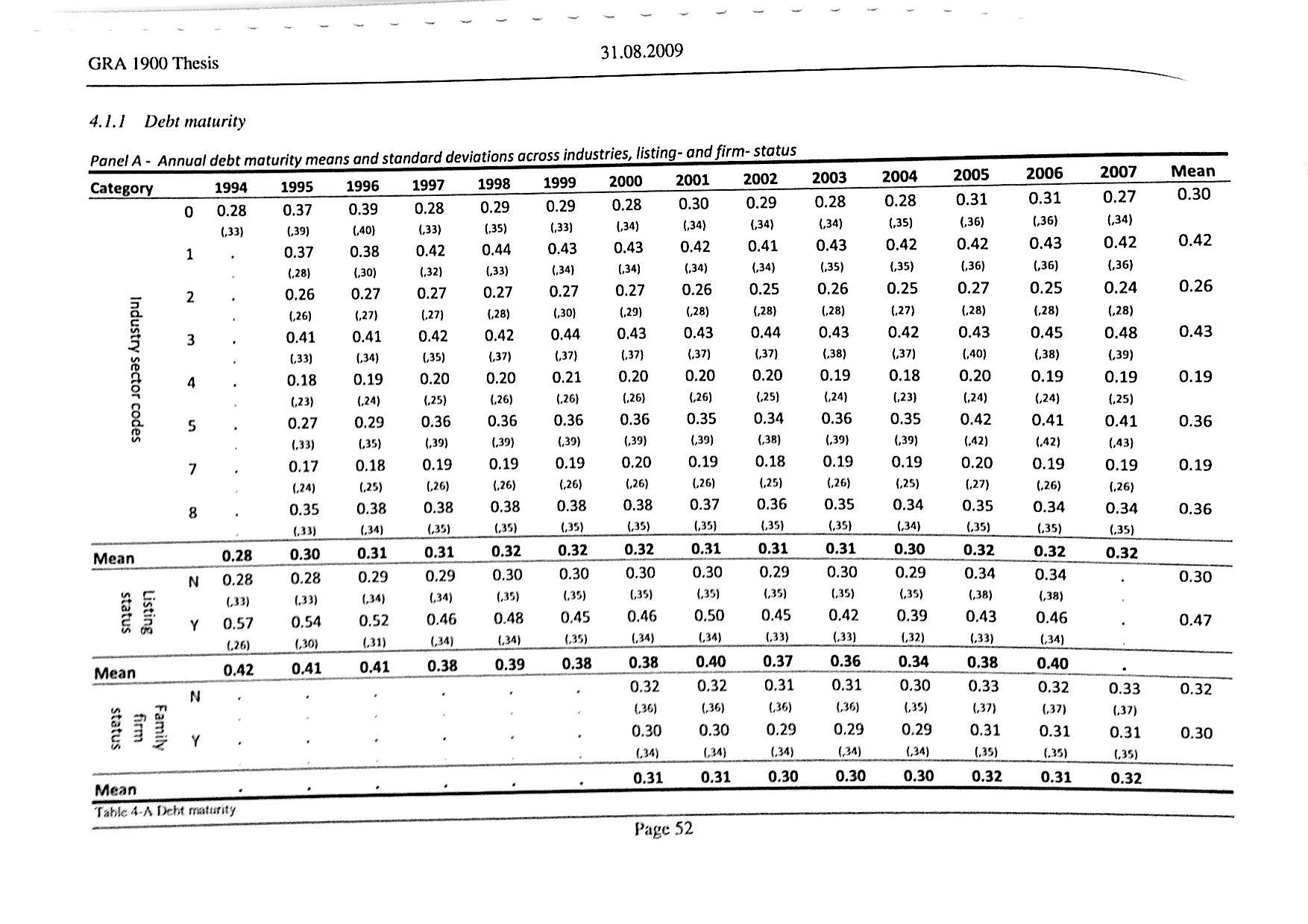

1. However I would like to create a table as the one attached to this post. The table shows leverage per industry and year and in addition provides information about the mean for the the whole period.
Essentially i have to combine the data somehow but I am not sure if I have to do this in different steps or if there is an option to do all this in one step(?!)
