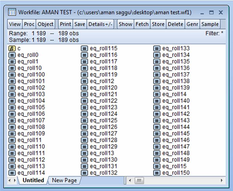

I often need to generate a large number of equations using loops, unfortunately when I label these equations with numbers they are organised in an unusual manner, is there any way to organise them in numerical order:
For example, if I have 200 equations named eq_roll0 to eq_roll200, EViews will display these equations as
eq_roll0
eq_roll1
eq_roll100
eq_roll101
… instead of
eq_roll0
eq_roll1
eq_roll2
eq_roll3
The screenshot may help to explain this more carefully, I could of course rename them all as eq_roll001, eq_roll_002 ect however it would be better if EViews simply organised these numerically

Postby EViews Gareth » Thu Jan 31, 2013 3:45 pm
Renaming is the only way to do it:
rename eq_roll?? eq_roll0?? rename eq_roll? eq_roll00?
