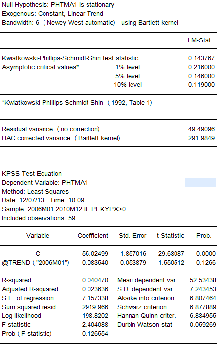

Newey - West covariance formula for KPSS
Postby alunde » Sat Dec 07, 2013 2:34 am
Dear Gareth
Wrote at some time that " which for the Bartlett kernel is m=floor(4*(T/100)^2/9), where m is described in the first paragraph of page 779 of the PDF version of User Guide II".
I can get that to match the output attached. Here T is 59 and the auto bandwidth is 6, but floor(4*(59/100)^2/9) = 4.
I'm aware that one gets 4, when runnning regression, do you mind explaining how you select it for the KPSS test. I look
through the manuals ... couldn't find it?
Kind regards, Asger Lunde
Kpss test screen shot
Posts: 2682
Re: Newey - West covariance formula
Postby EViews Glenn » Sat Dec 07, 2013 6:07 pm
Note that the formula you quote for the bandwidth is for the fixed Newey-West, not the automatic selection method as used in your computation and as described in some detail in the Appendix on long-run variance computation.
