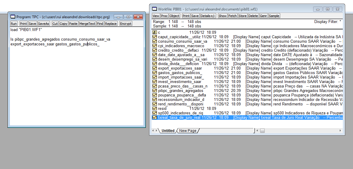

Hy everyone,sorry to bother with such trivial questions but it's the first time i'm programming.
I loaded a workfile using a programm created by me, but now i don't know how to write to estimate the ols in the programm.
i tried writing: ls (variable name) (variable name) (variable name) (variable name);
but it keep telling me my variables are not defined...
thanks

That error message indicates that your variables do not exist. It is hard to know what you've done wrong without further information.

Postby darkerthanblack » Mon Nov 26, 2012 2:31 pm
I added a print screen. I can open the variables, and see the data, on the panel to the right (sorry i don't know the name)
Re: OLS
Postby EViews Gareth » Mon Nov 26, 2012 2:32 pm
Attach your workfile.

Your variable names are actually:
pibpc_grandes_agregados_ consumo_consumo_saar_var export_exportacoes_saar_ gastos_gastos_publicos_s

Thank you so much!
