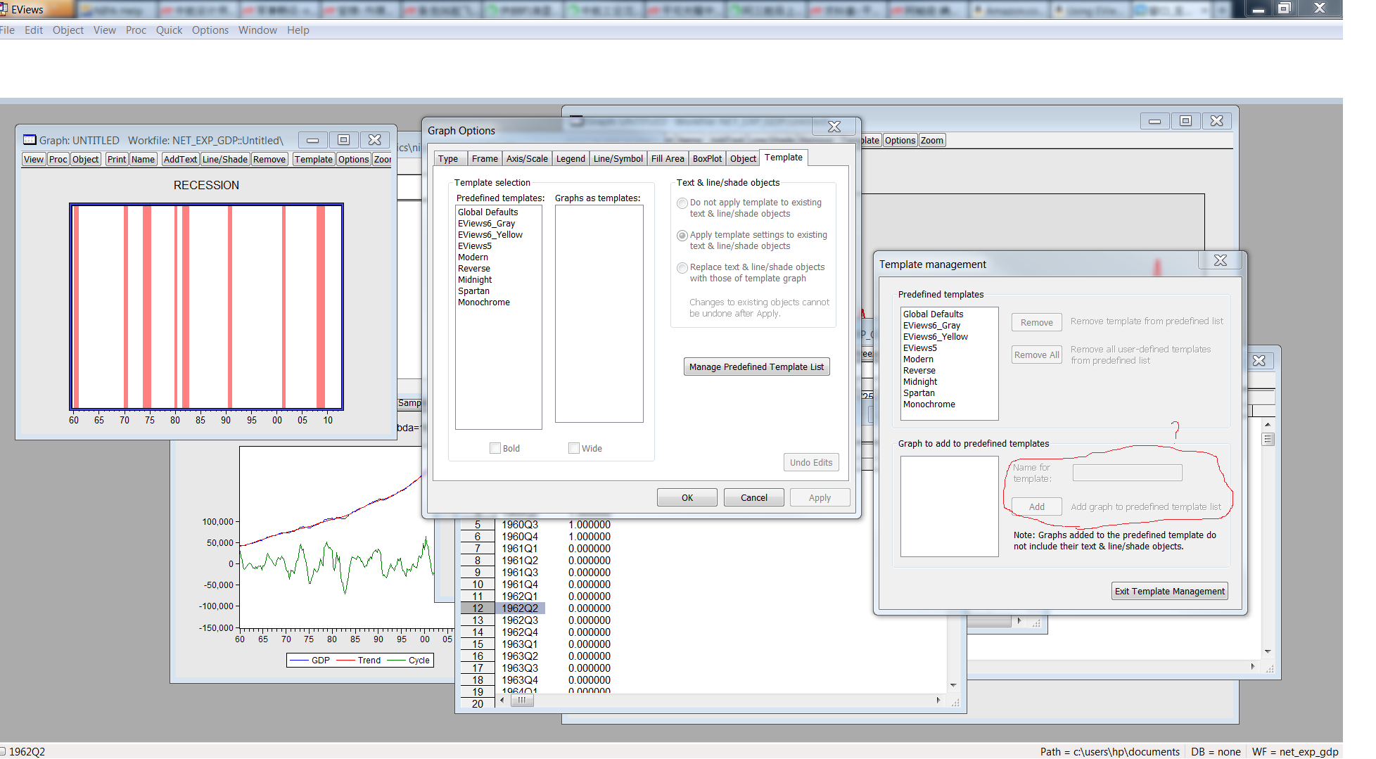

I am using Eviews 6.0. I created a graph with shaded recession periods. I want to save it as a template so that I can use it repeatedly. When I click the "Manage Predefined Template List", the "Template Management" window jump out. However, it seems I cannot do anything with this window because the "Add" option is disabled...What did I do wrong? Thanks!
Posts: 13610
Re: How to save a graph to use as a template
Postby EViews Gareth » Mon Nov 26, 2012 8:48 am
You have to name your graph before you can use it as a template.
