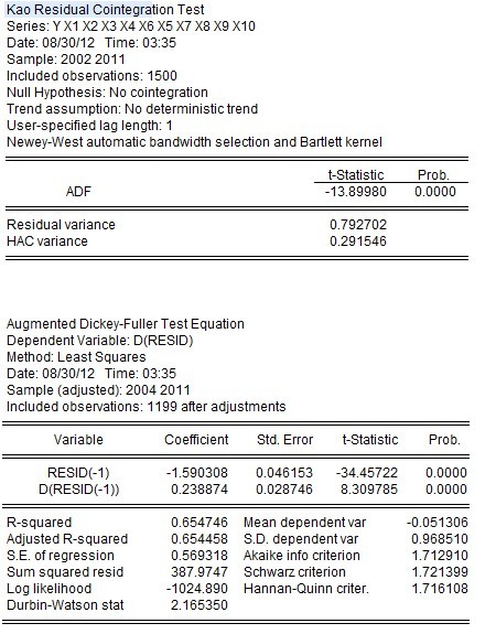

I have EViews 7.2 version. I was doing cointegration test for my panel data, when I selected Fisher(combined Johansen) and run the test, a error message says "invalid or duplicate specification or insufficient data for estimations." But If I select the other method which is Kao(Engle-Granger based), the test would be fine, it gave me result to reject the H0.
Thanks for any suggestion
