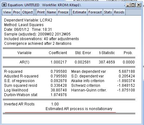

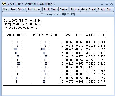

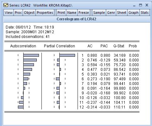

Actually I found the solution but I have a different problem related with an ARIMA model. Briefly, I have a time series from 2009 to 2012 with monthly freq. I firstly transformed it to logaritmics. Then I checked the correlogram (pic 1) but the graph shows me a non-stationary form. Then I created 1st difference of the values and looked at the correlogram (pic 2)which looks like a stationary form.
In the 2nd stage I generated a model. On the lef hand side I used log of my time series and on the right hand side I used the AR(1). When I checked the results of the model (pic 3) everything seems ok except "Inverted AR Roots". I says "Estimated AR process is nonstationary. I am not sure what I have to do at this step. If you can look at the printscreens for further information and share your thought, it will be appreciated.
Thanks in advance and regards.

Postby startz » Fri Jun 01, 2012 1:17 pm
Use the difference of the log on your regression.
