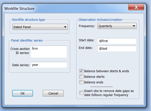

When you click on the Proc/ Structure/Resize Curent Page in the current workfile, what does it say?

Postby gastonpresente » Wed Feb 01, 2012 3:48 pm
Hello Glenn
I have attached a frame of what appears when I do that..
Eviews Resize.jpg (69.98 KiB) Viewed 216937 times
What do you think? There is no need for the dummies, right?
Thanks for your help
Posts: 2682
Re: Panel Data - Fixed Effects
Postby EViews Glenn » Wed Feb 01, 2012 4:14 pm
Does your YEAR variable indicate Year and Quarter? The built-in period effects will be for whatever is defined by YEAR.
