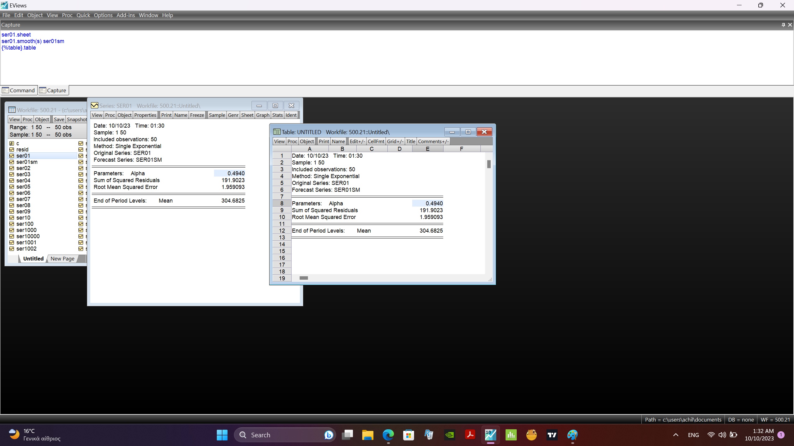

i would like to write an algorithm in order to be able to retrieve the smoothing parameter (a) in a table. So i would like to do it 10.000 times and that's means i will have 10.000 times the value of a. Could anyone help me??
I have already written the following code for only one series with my data:
freeze ser01.smooth(s) ser01sm
With this command i have the table with the results from simple exponential smoothing which is done only in ser01 and obviously the smoothing parameter (a). It is located in a 8Ε cell. I want to retrieve it and put it in a table.
