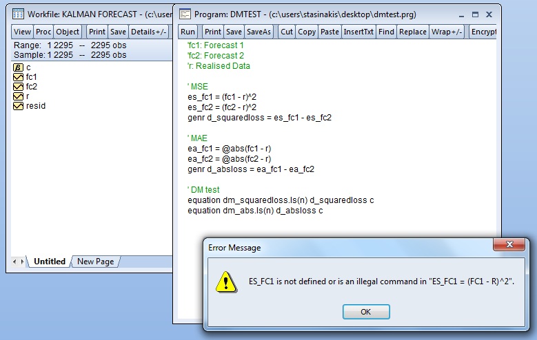

I am trying to use this code for the DM test but I get the error as in the image...
Could you help me?
Posts: 13610
Re: Diebold_Mariano Test
Postby EViews Gareth » Mon Sep 12, 2011 9:15 am
Put a genr in front of the line that sets them.
