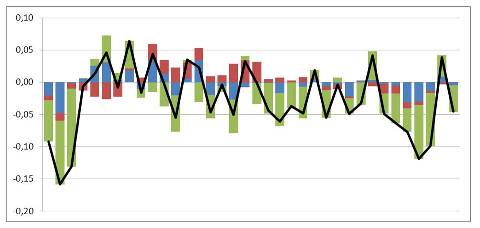

Hello, I'm confronted with the same problem. Bascially, I don't need different scales, but "only" a graph with stacked bars and a line (see example below). Is there really no way to build such a graph in EViews? I would highly appreciate to get any hints how to solve this issue.

Postby startz » Sat Nov 05, 2011 8:05 am
Something kind of like this?

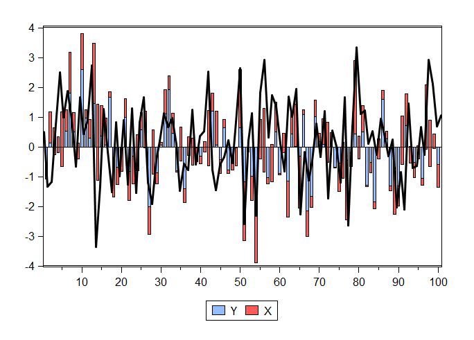

Postby EViews Jason » Wed Feb 24, 2016 8:39 am
It can be done in EViews 9 via mixed graphs.
group g x y z 'create a group containing x y z g.mixed stackedbar(1,2) line(3) 'create a mixed graph where x and y are stacked bars and z is a line
