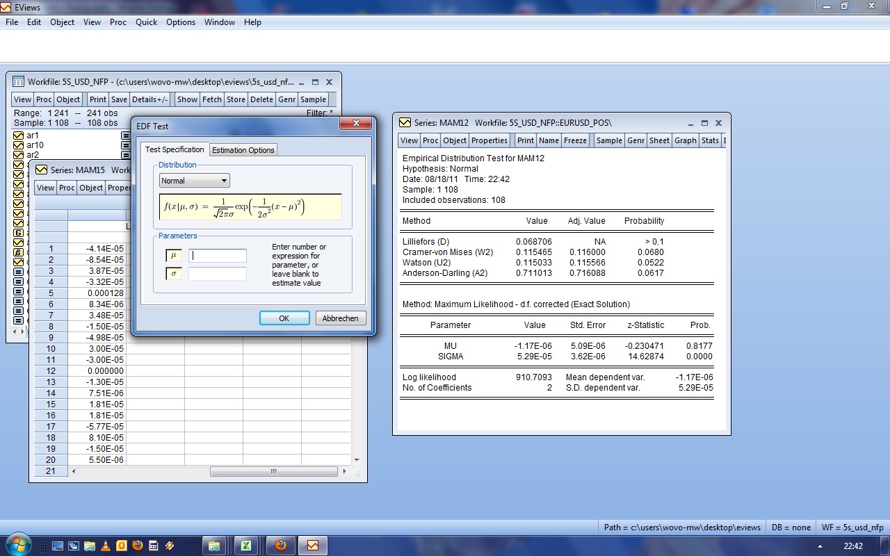

For example, the next thing i intend to do is grab a certain test statistic (Anderson-Darling) from the "Empirical distribution test (for normal distribution)"
- results table, however i have no idea what it's description is (just the same as the thing with "varinf" - how was i supposed to know?
(without asking the forum) ;D
