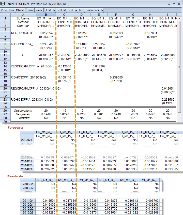

Can I add add forecast and residual series to the Equation Summary program show it will show in the equation columns, below the results and R-square? So that a single column contains an Equation Result, then the Forecast Series, and then the Residuals Series below. These are forecasts and residual series were created from the equation using .forecast and .makeresids, so they are kind of like children of the equation. I thought perhaps I could use an associated data member, but I do not see that as an option in the Series Data Members, and I don't see an Equation Data Member, but I could be missing it. I am attaching a (really rough) mock-up of what I have in mind in case it will help paint a picture of what I want to do. Any advice would be appreciated!
I have only worked with EViews for about 6 months but I love it.
I made two other changes to the Eq Summ program - I added the p-values to the coefficients (listed under the t-stat), added a 10-percent significance level (I did notice somebody else did that a couple of years ago
), and I added the DW stat below the R-square.
- rough mockup
- EQ_.summary_mockup.png (90.15 KiB) Viewed 67717 times
- less rough mockup
- EQ_.summary_mockup2.png (71.29 KiB) Viewed 67717 times
- Posts: 13612
Re: EqTabs (Equation summaries)
You'd have to program it yourself. The reason that forecast and residuals aren't datamembers is that they require extra calculations, and options. They are not stored with the equation by default, but are recalculated every time you do .forecast or makeresid.
What you'll have to do is add a line that forecasts from each equation (eq.forecast yf), then freeze the sheet view of the resultant forecast series into a table, then extract that table into the summary table. The only tricky bit will be getting the sizing/placement of the table correct. Finicky.
