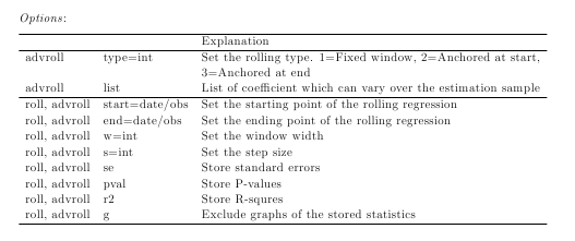

  • 2012/04/11 - Command options are added
rolling regression command options.png (28.86 KiB) Viewed 77174 times
