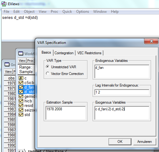

First of all, thanks for the answer! I included the parameters in
the appendix, is this the correct methode?
donihue
Posts: 139
Re: VAR problems!
Postby donihue » Mon Jul 25, 2011 9:37 am
No! You should put "d_fan d_std" (and whatever your third variable is) under "Endogenous" and leave only "c" under "Exogenous"
Regards
Donihue
