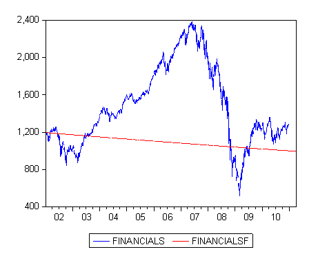

Can someone tell me if there is a setting I can change when I creaste a Dynamic forecast to capture the volatility of a series? I have uses an ARMA(1,1) to model the series attached (it is daily data) but the forecast just gives me this straight line. I see a Static forecast is more realistic, but I want to forecast multiple days forward.

That is impossible. You'll have to model the volatility.
